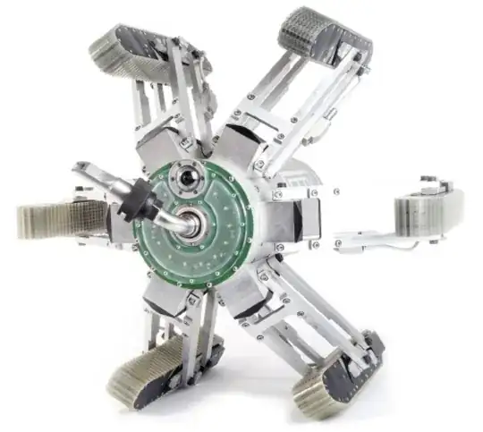

I found a great mechanical solution, but it's possible that your pipe size would be too small: http://www.jettyrobot.com/
jetty robot
It appears from the image that the diameter is adjustable, but without scale, it's difficult to determine how small it will collapse. The options are great, walnut blasting, dry ice blasting, sand blasting, but is it too big? I'd try the dry ice blasting, as there would be minimal residue as the CO2 sublimated, but it's also possible that dry ice isn't power enough to bust up the epoxy.
