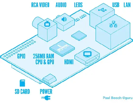

Using the Raspberry PI is most probably a very good idea, Its cheaper version (Model A) about £20, it can run Linux, you can use a WiFi dongle with it. You can remote into it using SSH.. so yes it is actually a very good solution.

I am still waiting for my Raspberry to finally arrive and then I can experiment with it. But from my understanding it does have GPIO as on the datasheet page 89 and are available on the PCB it self as double row pin headers. I suspect you can use these to read analog values such as voltages so you could easily connect a temperate sensor like LM335Z. I still have not seen any code on how to do that though but this does seem like the best solution now a days.
