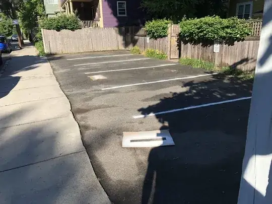

Our home owners association's community parking lot lines are wearing off, about 5 lines, and I'm interested in respraying it instead of calling a professional.
I bought a Rust-Oleum Professional White Paint Spray, and I'm not sure how to avoid over spraying, all I can think of to get the job done is to use General Purpose Masking Tape (ones they use for painting) but that'd likely require at least 3 lines of tapes for each side of the parking line.
Update
Ended up going with the top solution here, and managed to create a stencil after buying grill (its box size was perfect), worked great, and it was a real fast job with this approach.

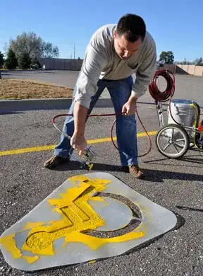

Make a stencil. That what road markers typically use for arrows, symbols, letters and numbers .
Easiest would be out of some cardboard boxes. Flatten the boxes, cut them and create a stencil with a gap shaped like the stripe. Place on the road, spray paint, then re-position for the next stripe.
Illustration from Asphalt Line Stripping:
Road stencil

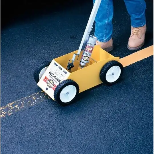

It sounds like you need a Line Striping Machine. If you search your favorite search engine, you can find one of these fairly easily. While there are higher end models with special paint reservoirs and compressors and all that jazz, there are also simpler ones that simply mount a can of spray paint like you have and hold it a constant distance from the asphalt as you roll it in a (presumably) straight line -- these seem to run as low as $75, possibly even less with a little more internet legwork.
Here's an example of a lower-end line striper, available via your typical big box home improvement stores (though often by special order, see their sites for details). This particular image is from Home Depot:
Low end line striper

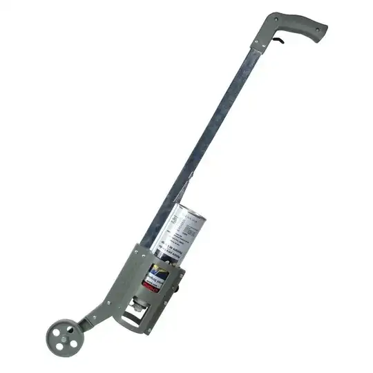

There are even single-wheeled "striping wands" that are cheaper yet (ranging from about $20-50), but one of the four-wheeled stripers will make straight lines easier without having to set up any sort of guides; just measure where you want the lines to start, plunk the machine down pointed in the right direction, pull the trigger and walk. A striping wand looks like this one (image also from Home Depot, though be aware it got poor reviews regarding build quality and paint can compatibility):
Single-wheeled striping wand
