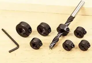

The correct way to do this is to use a drill stop.
drill stops
Drill stops are less likely to slip than tape or zip-ties, and are much better for precise and/or repeated drilling.
If marring the finish is an issue, clamp a piece of 1/8th plywood over the site and adjust the drill stop accordingly.

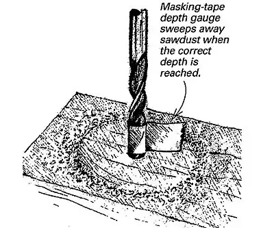

I usually just wrap a piece of masking tape around the drill bit leaving the correct length exposed. You can either wrap enough layers of tape around so that it is fairly thick, or leave a "flag" of tape sticking out. Either way will let you drill to the proper depth without the risk of marking the surface. The metal jaws of a drill can easily damage the surface if you allow them to come in contact.
http://www.finehomebuilding.com/how-to/tips/more-masking-tape-uses.aspx

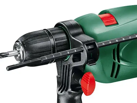

There is also that stuff that you always leave in the box when you get a new drill... (if your drill is equipped with a drill stop) then this is when you would use it.
