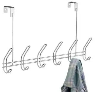

You could use over door hooks, such as this, on the bathroom door.
