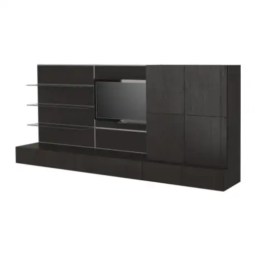

  • get an entertainment system designed with its own 'wall' panel. Ikea has several, for instance: enter image description here
