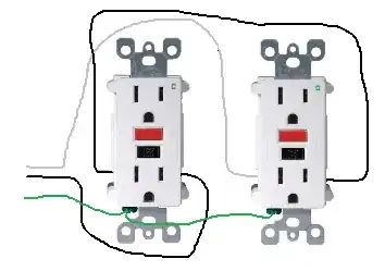

GFCI receptacles have two sets of contacts, line, and load. The Line side of the receptacle is used to power the device, while the load side is used to power other devices down the line. Any device connected to the load side of a GFCI receptacle, will be protected by the GFCI receptacle.
For example, if you have a setup like this (which I assume you have).
There is no need to have a GFCI receptacle as the second receptacle, since it will already be protected by the first GFCI receptacle. Because of this, if the first device trips all devices on the load side will not be powered (as you have noticed).

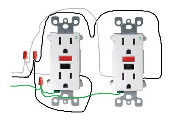

You can use pigtails to connect the receptacles like this.
But in a setup like this, you'll be required to have a GFCI receptacle at both outlets. The devices down stream are no longer protected by the first GFCI receptacle, because they are not fed by the load side of the device.

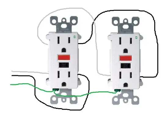

This is what it would look like if the receptacles were wired in series. enter image description here
This is the correct behavior. You only need 1 GFCI outlet per circuit (assuming it's at the beginning of the line and the rest of the outlets are loads).
They are correctly wired in parallel - if they were in series, you wouldn't get the correct voltage at the other outlets when there is any type of load present.

What you need to do in your situation is to pigtail wires in the box before it connects to the GFCI, and to run a cable to the next outlet, which will now be unprotected unless you also use a GFCI outlet. (SEE TESTER101's answer with MSPAINT!!!) I believe the code says GFCI's are required within 6 feet from any sink. I go a bit further (9', with some common sense), to ensure that I can't touch the toaster with an 18 inch cord, with my 10" chef's knife while touching the sink. I also have stainless steel appliances which look like an attractive ground to me, so I treat them as if they were sinks.
