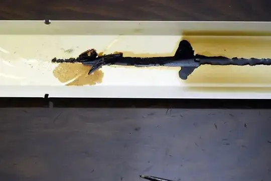

I went to replace a some fluorescent tubes that looked like they burned out, but after disassembling it a little to get the tubes out, I saw something a little alarming:
There was a black sticky substance on the inside cover of the housing:

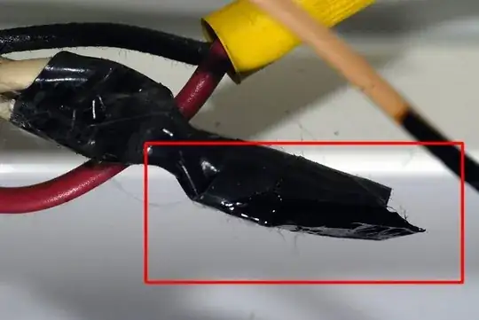

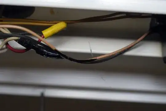

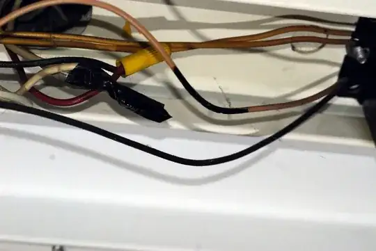

Picture #1 of what looks like a "burned" wire and "melted" electrical tape
Picture #1 of what looks like a "burned" wire and melted electrical tape
Picture #2 of the same
Closeup of the "melted" electrical tape:
Closeup of the melted electrical tape

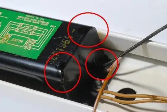

The electrical tape was not melted, and the wire was not burned. The culprit was indeed the ballast. Here are the leaks:
The ballast
Thanks, lqlarry!

  1. You didn't show the ballast, (the black boxy thing with all the wires coming out of it in the fixture) so my guess is that it went bad and some of the potting insulation around the coils of the ballast over heated and melted. (Since I cannot see the whole fixture I'm just guessing about that.) It looks like the black on the cover is a tar type residue but I really would not touch it. It is sticky and a mess to get off.
  2. I doubt anything was catching fire, but when it happened there would have be smoke and a really stinky smell. If you smell the ballast you will see what I mean. But back to the fire, I'm sure this has caused fires in a very few cases.
  3. I would disconnect the power or turn the switch off. The ballast has a thermal cut-off that would probably de-energize the ballast, but it still has power.
  4. It can be fixed, but for a DIY'er it is easier to change the whole fixture. To fix it you would have to wire in a new ballast and that would be 8 wires, where a new fixture would be only 3, a hot, neutral and ground.

The ballast failed because of arcing caused by an incorrect connection. IE your elecrical tape connection was loose and over time the small contact points increased in resistance. This could have been prevented by following code and installing a wire nut instead of twisting the wires together and taping them.

There's nothing wrong with the fixture. I retrofit fixtures like this all the time. In fact, a good, stout old fluorescent fixture is better than any of the new replacements made out of flimsy sheetmetal.
However, the Ballast has failed. And this is time for an upgrade anyway. This is an old "magnetic" ballast, which works with specialized transformers. To keep the transformers from buzzing, they fill the ballast with tar. The aging transformers run hotter, melting the tar until it leaks out.
There's nothing wrong with the wires, they were just dipped in tar. You can clean it off the wires with paint thinner and patience if you really want to.
Other than that, you can disregard the tar.
The "electrical tape splice" is terrible workmanship and you will be replacing it with a proper splice - a blue or orange wire-nut should suffice.
