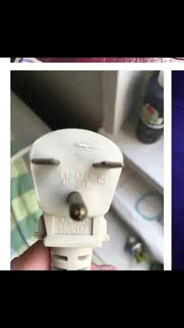

My unit's window mount A/C unit is pictured. I am looking for a converter of some sort so I can use a utility supplied shutoff device.
The Unit itself does not have a temperature control or setting. Just on/off, high/low. The electric company provides the wifi plugs as a way to help control energy costs that connect to the AC unit, and I can control the temperature on my phone via wifi vs it just running all day long.
I cannot afford to run my AC all day, but have a pet and cannot leave it off all day. I am looking to attach one of those plugs that my electric company has to shut on and off when it reaches a certain temperature in the house. However, I don't know what this is and how to convert?

Your AC unit needs 240 volts to operate. While most houses in the US have 240V, most outlets are only wired for 120V. This is a limitation based on both the outlet itself and the wiring to it.
If you want to use this AC unit in a room without 240V, you need to have new, heavier wiring installed to that location.

That's a NEMA 6-15R 250 Volt 15 Amp socket ( http://www.plugsocketmuseum.nl/NorthAm-3hd.html ).
Many utilities offer discount programs (for example "CoolCents"), where you get a discount but agree that during peak usage times, your AC may briefly be disconnected. These programs once relied on pager based shutoff devices, but they're moving to "internet of things" and wifi connected smart thermostats. Check with your utility company for details. That plug is NOT that uncommon, if a device is available, it should be OK available with that plug.
A plug converter, even if you made one, would not help you use this 240V unit with a 120V plug.
Consider sun shades, an attic fan, or other passive or less costly methods to keep the temperature down. Window AC units are not that efficient, especially if sun shines directly on the coils on the outside of the building. YOU CAN DO MORE WITH SIMPLE CONSERVATION THAN FANCY ELECTRONICS.
Consider just turning the temperature dial to the highest possible temperature. The device will run only as much as needed to get to that set point. The A/C does not use energy when the temperature is above the set point.
