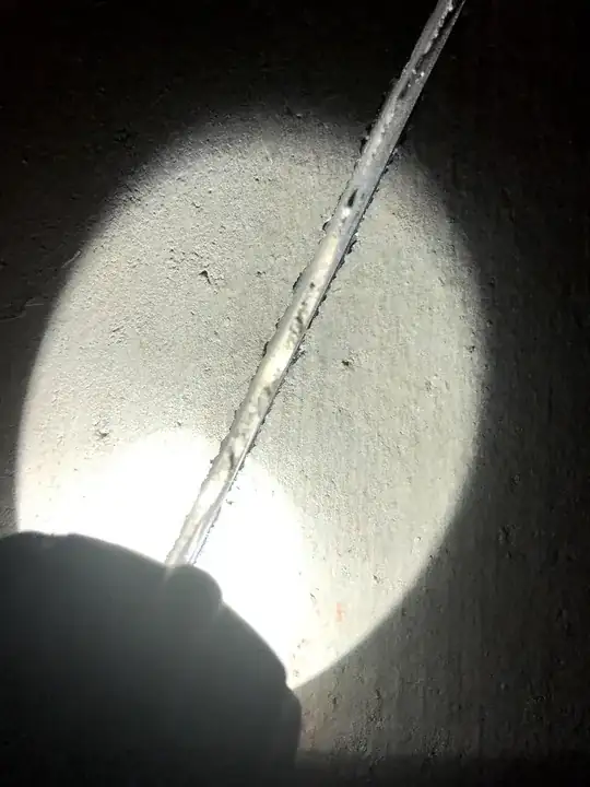

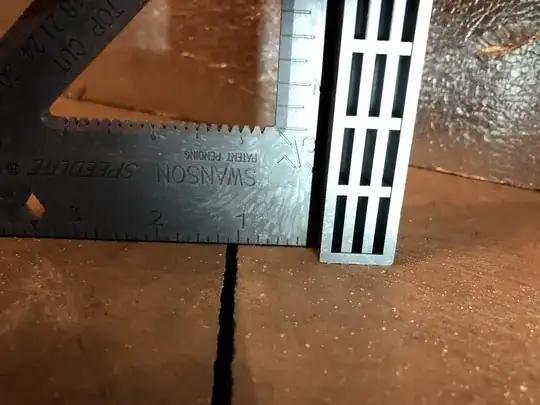

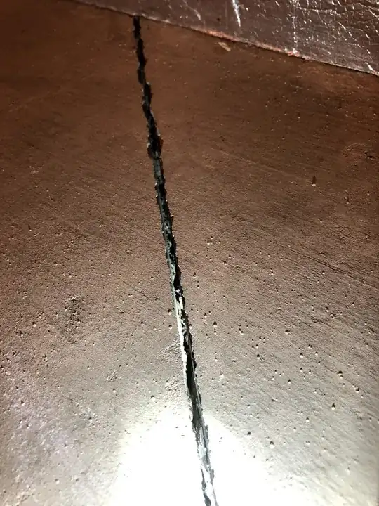

Our home was new construction and the basement floor was poured around 1.5 years ago. The builder installed control joints in several locations in the basement slab. Several of these joints have widened. The widest crack is now around 1/8th inch wide with certain sections as wide as 3/16th inch wide. When i shine a flashlight down this wide section it looks as if i see gravel below although i'm not sure if that is just rough concrete since the floors are supposed to be 4 inches thick.
Is this widening normal? Should i seal these cracks to prevent moisture and soil gasses from getting into the house? control crack in floorpic2pic3

Your pictures show the slab “level”, so you do not appear to have any of these conditions.
However, EXCESSIVE movement caused by excessive amount of water in the concrete mix is more common and appears to be your problem.
There is an exact amount of water to be used (mixed) with Portland Cement to give it it’s ideal working consistency and strength. We call this it’s water/cement ratio.
However, it’s tempting for workmen to add additional water to the recommended mix design so that it is easier to “work” the concrete before it “sets”.
However, when this is done, then more water causes greater shrinkage when the concrete dries (cures). Your concrete must have been very “wet” because there is an extremely large “shrinkage” crack now. In fact, now the tile has cracked where the slab has shrunk and cracked.
When we get involved in fixing these types of cracks we monitor the crack to make sure it has stopped moving before we fix the problem.
I’d recommend that you tape a plastic ruler to one side of the crack, install a box over the ruler so it can’t be moved, and then create a photo journal taking pictures each month for 1 year and writing down observations: like width of crack, outside temperature, room temperature and humidity. Usually after 1 year you’ll know if it’s stopped moving. (That is to say, you’ll know if the slab has stopped shrinking.)
Then, to repair the problem, I’d add a tile “expansion joint” directly over the crack.
Because the concrete crack is irregular, the two slabs will probably not move up or down causing differential settlement. Just make sure the slab has stopped shrinking. It may take up to a year.
