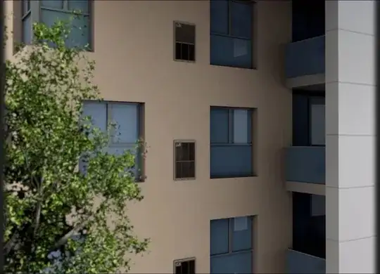

We are in a multi-story, multi-unit building that uses packaged through-the-wall HVAC systems in each unit. These units often go under the name of "Magic-Pak" or "Comfort Pack" depending on the manufacturer. What's especially unique about these systems is that they are not free standing, but are instead mounted on hardware that is directly integrated into the wall structure and facade of the building.
Here's an example of what this would look like from the outside. In our case the surrounding structure is more of a steel and glass curtain wall, but the principle is the same:
