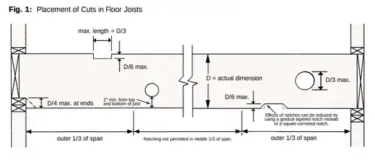

If you need to route cable through the joists, you can notch or bore holes in the joist. The illustration below shows that you can notch the OUTER thirds of the joist a maximum of one sixth the width deep and one third the width long. Wires in notches will require a nail plate for protection. Bored holes can be up to 1/3 the width of the joist, but must be 2" from the edge. With 2x6's, the actual width is 5-1/2" so there is room to spare for holes in the 3/4" to 1" range centered or nearly centered through the joist.
WWPA - Placement of Cuts In Floor Joists
