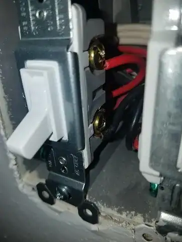

I have a single pole light switch with a hot red wire secured at the top and a hot black wire at the bottom. I then have a handful of outlets wired with the metal tab broken separating the hot red and black wires.
However, all of the top and bottom outlets are always hot. The switch isn't doing anything. I tried swapping the switch (on the off chance the receptacle wasn't working) with a different one in the house that is working, but that didn't work either.
What could be causing the switch to not terminate?
A few (mediocre) photos below:
Switch:
switch

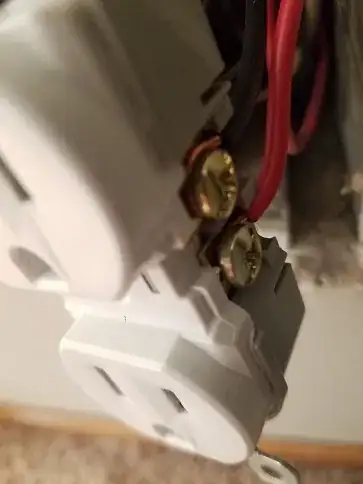

Hot wires with broken tab:
outlet hots, broken tab

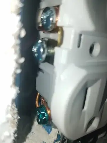

Neutral (top) with tab connected and ground:
outlet neutral
You said the switched receptacles are chained all around the room, so each receptacle has a switched and unswitched socket, am I right?
One of the other receptacles still has its tab. That's all it takes.

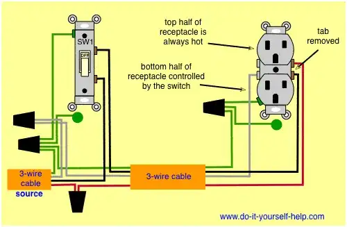

Looking at your pictures, and reading your new comments. Here is what I see, you have a red and black wire attached to your switch and a red and black wire attached to both sides of you receptacle. Are the red and black wires the same wires? Because if they are then where is you hot or source wire?
If you have a voltmeter or a non contact indicator check to see which wires are hot. One attached to the switch and one attached to the hot side of the receptacle should both be constantly hot. The one attached to the switched side of the receptacle should be hot when the switch is turned on. You are right in saying it should be fairly straight forward. I have attached a sketch. enter image description here
