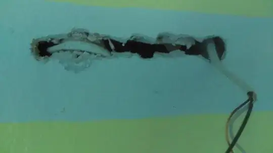

I uninstalled my old bathroom light fixture to replace it with a nicer light but found that there is no stud and no wall box behind the sheet rock. The old light fixture is very light but the new one is not. Is it safe to attach the new light fixture without studs or wall box to attach it to? Would it be safe to just use wall anchors or do I need to hire a professional for this job?enter image description here

I found almost that exact same image behind a bathroom vanity light fixture that I took down to replace. Needless to say I was flabbergasted that such garbage workmanship would be hidden behind a fixture.

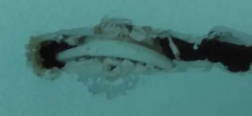

You should look very closely at what is just behind the place where the romex cable is coming out one hole and reentering the wall cavity at the slot on the right.
Mine looked exactly like that and there was a stud right behind that cable loop.
I opened up a hole to the right of the stud for a suitable metal electrical box. I then drilled a hole through the center line of the stud from side to side and worked the wire through the hole. I then mounted the electrical box to the side of the stud and brought the electrical cable into the box and secured it with the box clamp at the rear of the box. Now it is properly wired but I had to work at finding the proper lighting fixture that would cover up the messy slot in the drywall. (I would have patched and painted it but decided to wait till I give this bathroom a facelift remodel in the near future.

That's terrible. Whoever did the work did very shabby and unsafe work, and you may have a house full of that.
One option is an "old work" (meaning retrofit) junction box that attaches directly to Drywall, however drywall is basically schoolhouse chalk wrapped in paper soaked in glue, you don't expect it to have any strength. It's a basically useless material except for being cheap, holding up paint and being an absolutely fantastic firestop.
A better option is an "old work" lamp or fan box, which has a built-in metal cross-arm. The cross-arm fits through a sensibly sized junction box hole, but telescopes out 15" so it can bite into the nearest ceiling joists. That is how it carries the weight of a heavy light or the dynamic vibration of a fan. Then the junction box proper is able to clip onto that cross-arm at any needed position. They are quite clever.

I worked as an electrician for a few years. Normally it depends on the light fixture you are mounting. The reason why we just stub a wire out is vanity placement. Sometimes we cant get a box mounted in for a few reasons. Plumbing vent stacks, stud placement, and round cut in boxes(old work) will show around the fixture. If the builder placed a nailer for a round nail on box to be used then its great. Normally they dont. We just use a fixture designed for the wire to be spliced inside of it, and use a romex connector. Then we can center it on whatever vanity it's going over. A plastic box supports weight of the fixture. Its max is 25lbs. I believe a single gang nail-on is 9lbs. Weight shouldn't be a problem. Agreed they should of drilled through the stud and slid the wire through it or at least protected it. I agree it looks shoddy but if a licensed electrician did that they he had a bad day and the wrong light fixture was purchased by the homeowner and not correlated with builder/plumber/electrical contractor for box placement. I hope this clarifies the shoddy look. BTW metal studs require a bushing be placed in the pre-cut holes to keep the wire from chaffing.
