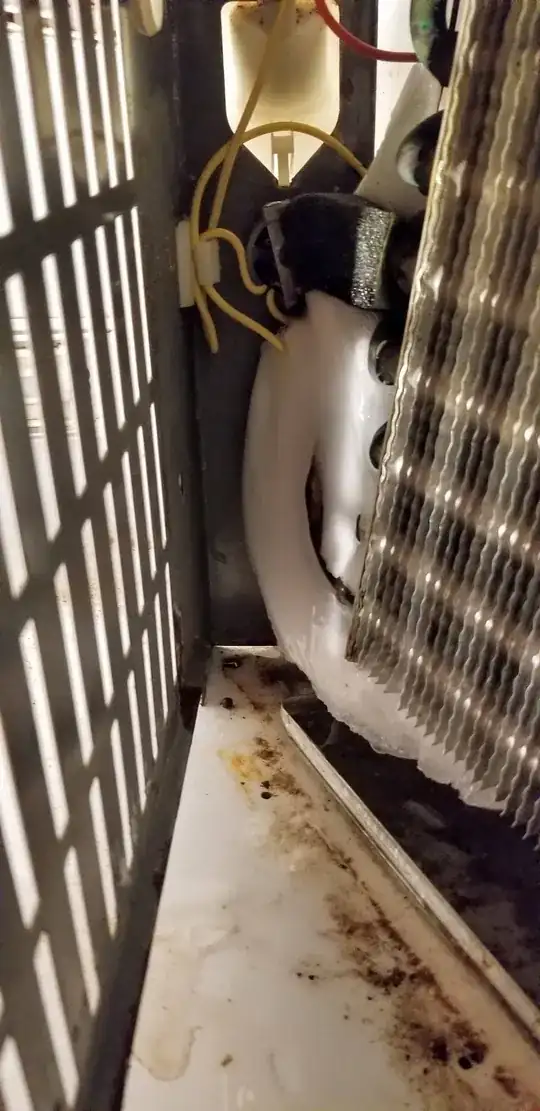

My fridge is getting cold enough to quickly produce huge amounts of ice (see picture below) despite being fully defrosted (I used a heat gun) but it can't get below 50° F. Does it matter that all the ice is concentrated on one side/corner and not over the rest of the coils?
If it matters, I spent a solid 2 hours last night fully unclogging a horribly clogged drain hole. I also put an additional fan inside the fridge, trying to circulate more cold air, but it didn't seem to do much.
Does having ice mean my compressor is working? Could it be an issue with my evaporator? Would love ideas of things to check!
Edit: my Fridge uses R134A frozen parts of coil

That is a sure sign that the refrigerant has leaked out. There is just enough left to freeze over the first bit of the coil as the remnants flash vaporize after passing through the expansion valve due to high suction. If a meter set was connected, one would find low high side pressure and high low side pressure.
If it wasn't a high priced refrigerator or is out of warranty, don't bother with a service call, just replace it. Do not attempt to repair it youself unless you have a EPA 608 or 609 license depending on if it is a R410A or R134A unit.
