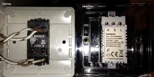

This time, I'm looking for a some assistance in fitting a a single electric dimmer unit.
I am trying to replace my existing light switch with a LightWaveRF dimmer but am also have an extractor fan which powers on which this switch is on.
I took a guess but is anybody able to confirm the correct wiring (I'm in the UK) for such a setup?
Here are the old and new switches:

Technically that is the wrong switch for what its doing. That switch is designed to isolate both the incoming live and neutral. However i can see it has been jerry rigged per se as the incoming live and neutral at the top has been bridged to serve another purpose. You are going to have an issue with it. Are you able to indicate which of those cables goes where?
