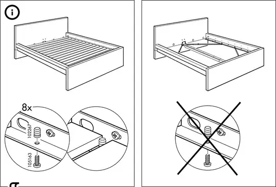

Yes. You can use slats instead of a box-spring. It will be a LITTLE bit stiffer, but it's perfectly fine and you'll love how your bed squeaks less. Here's a pic from an Ikea bed frame assembly guide - just as an example:
