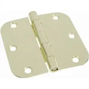

I'm assuming simple door hinges here, like these
alt text
