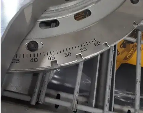

The most efficient method I can think of for cutting the tapers would be to use a compound mitre saw. However, the most severe angle/taper that can be cut with the compound mitre saws I've seen is 60 degrees.
Unfortunately, 60 degrees is not a severe enough angle for my purposes. The 60 degree taper does not penetrate hard clay soil well enough when pounded with a sledge hammer.

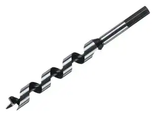

My first thought at seeing the "penetrating hard clay soil" was to use a wood/spade drill bit to drill a pilot hole in the ground before trying to tamp in the stake. There are also wood augers that might work better, as they are similar to the standard twist drills, except with a much larger groove for removing material.

Wood auger:
Wood auger drill bit
https://pjcplantservices.co.uk/wp-content/uploads/Wood-Augers-Bit2.jpg
I have a feeling that the stake won't maintain it's cutting edge with such a long tip, so you might be hurting your changes, rather than helping, them by making the angle more pronounced.

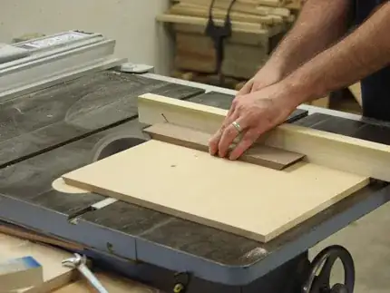

Ok, so this part uses a table saw: Using a sled, you can rig up a jig to allow you to make your 70 deg cuts. Even radial arm saws might not have the travel you need to cut the 70 deg angle you're looking for, but you shouldn't have a problem with the right sled on a table saw.
Table saw sled:

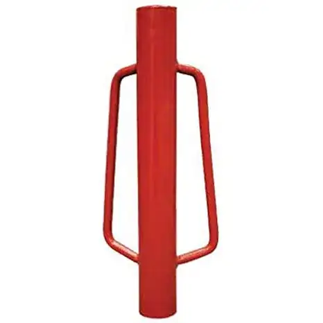

Also: You might want to invest in a fence post driver, since slinging a sledge hammer at a 4' fence post isn't going to be easy. Also with them being wood, you're likely to crack them with a sledge. A driver is likely to give you a centered hit that is much less likely to split the wood.
Even if the stake splits/mushrooms the end, the driver will help you keep the stake in one piece, since it would encircle the split wood, helping to prevent it from splitting it further.
Believe me, a driver like this is much easier to handle than a sledge, in many ways. Guaranteed hits, no bruised feet/shins/knees/ankles, no broken bones, better balance, and they stay on the post when you need to take a break (just to name a few benefits).
