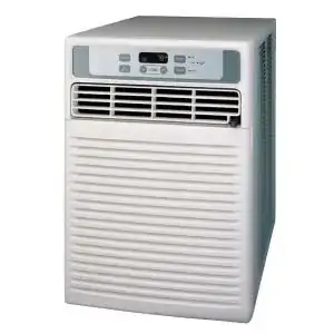

Most window units are designed for double hung windows. If you want to place it in a casement window (or a sliding window) you really should use a unit designed specifically for that. Here's an example:
http://www.homedepot.com/buy/building-materials-heating-venting-cooling-air-conditioners-fans-air-conditioners-window/lg-electronics-10-000-btu-casement-window-air-conditioner-with-remote-185631.html
However, anything can be hacked. If you build a proper bracket/shelf, and then enclose the top part (plexiglass, for instance) you can probably use what you have (provided it fits, of course).
