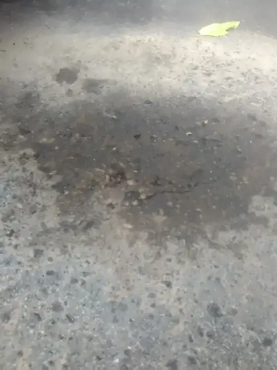

I am looking to repair a driveway damaged by transmission fluid (ATF) in the photo below. As you can see the driveway has pitted and cracked where the fluid was standing. Once winter comes I expect the freeze/thaw cycle will wreak some real havoc.
cracked and pitted asphalt due to contamination with ATF
There are two other small holes in the driveway caused by a floor jack, which I intend to fill with one of the products available at home improvement stores.
Is there a good way to dig or scrape up the ATF contaminated asphalt so I can use the same product to fix this damage? Or is there another preferred fix for this kind of damage?

The approach I'd recommend (based on my experience with this repair), is to use a heavy chisel to dig out the softened asphalt, then use a cold-fill pothole repair product to replace the material that is removed.
This gives a better result than using a saw, as the filler material blends (visually) better with the existing driveway when it doesn't have straight lines around it, and it prevents the removal of undamaged asphalt.
I tried the saw method on the larger patch pictured, and the dig/fill method on some smaller spots, and the latter gave a superior result.

With a diamond blade on a gasoline powered saw you could remove a neat square out of the pavement, and then fill with fresh concrete and/or asphalt. Such saws can usually be rented.
