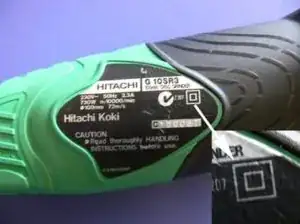

Look for a symbol like this, the "box within a box" as described earlier. It means it is "Double Insulated" and the grounding pin is not necessary.
