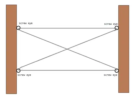

I recently posted a similar question, but the design has changed, so here's the new question.
I have two 4-ft x 4" x 4" wood posts, and each post has two screw eyes. There's 12 feet of distance between each post. I would like to recreate the design in the image, but I want it to be tight, not sagging. I'd use a 3/4" rope with no stretch.
How can I tighten this rope so that it's taut? Once it's tight, I'd Like to use a knot to secure it (I'd rather use a knot than a crimp sleeve).
Since this more decorative, I can pull and then tighten, but I prefer using something that can make it even tighter.

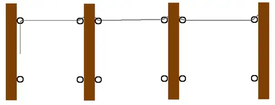

Fence with the upper rope only

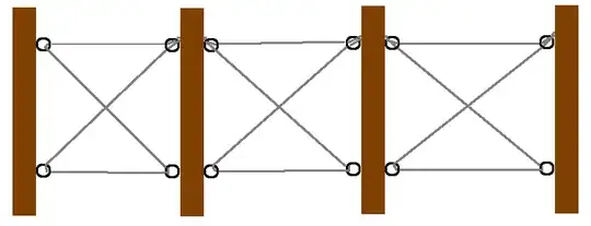

Now complete the end fence panel by running the rope diagonally, horizontally, and then diagonally again. This will leave the end of the rope in position to to go behind (or through) the post to get to the next panel. Continue until all panels are complete. Then secure the end of the rope to the same cleat you used before. (Or could be a different cleat if you prefer.)
Completed fence
Any time you want to tighten the rope (due to stretching or whatever), just untie one end from the cleat, pull it tight, wrap it around the cleat a few times so it won't slip, then tie it.
