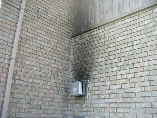

While I was out gardening, I saw a wasp fly through a small hole beside my basement window and into my basement. Then later, I saw five more enter through two other holes (two in part of my AC, three in my fireplace exhaust area.)
The exhaust area looks like this, but with four small holes in the metal plates where it attaches to the wall. That's where the wasps go in.
I taped up the basement hole as a temporary stop-gap. My questions are:
  • What should I use as a permanent seal?
  • Should I seal all the wasp entrance holes?
More importantly, what do they want and how do I get rid of them? I assume there's something in the house (food or a nest) that they're after. I can't find it, and don't know how to look for it.
I would like prevention (no more wasps coming) over protection (spraying all the entrance holes with bug killer) if possible.

If it looked like a wasp, then it still has a nest there. A wasp will not just wander into a hole. It has a reason to go in there.
No matter what it is, I would suggest dusting the hole with an insecticide. (Delta Dust seems to work well for me. I use a bulb to inject the dust into a hole. Carpenter bees are not aggressive, but then stand well back, in case these are more aggressive wasps or hornets.)
If you find carpenter bees tumbling from the nest, wait until they are all dead. The last nest I got rid of had 15 (LARGE) bees in it. I had to repeatedly dust it until they all were dead. Then you need to clean out the galleries (I use a Rotozip tool for this) and fill them with caulk or Bondo, as otherwise the bees will just re-inhabit next year. And if you just fill the entrance hole, a hungry woodpecker may still find that nest.
Once you manage to eradicate the nest, yearly spraying will prevent them from building new nests. They will just find other places to live, NOT in your home.
Get a product like HotShot for killing wasps. Foam up the mouth of the nest. It will likely finish the job.

seal the holes with the expandable foam. The wasps nest are made of paper and are not a problem to leave them in your wall.

Regarding where the nest might be - how thick is the wall? If there is more than just that brick layer then the nest might be inside the wall. It might not be very big. They can make a nest anywhere they can get to. I would say that if there are wasps (or bees, or whatever), and multiple of them, going into small holes, then there would be a nest of some description. If they were searching for food they'd be doing it out in the open. The way you describe it, it sounds like they know where they're going, so they're probably going home.
There are many types of wasps, so could you describe it at all? This may help identify it and thus what kind of nest it might be making, if any.
If you seal the holes with some kind of filler (anything really that won't wash away) then the wasps won't be able to get in or out and the ones in the nest (if there is one) will eventually die of hunger. Assuming they are in the wall and there isn't a way out into the basement, in which case that might not be so good.
