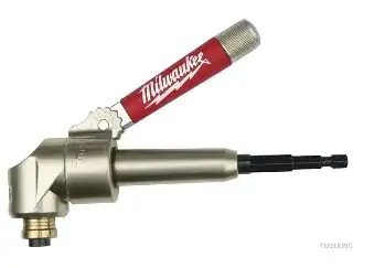

They sell what is called an "Offset" drill. Instead of the chuck being inline with the motor, it is turned 90°.
They also make drills where the chuck can be turned to get into tight spots. They also make an offset attachment for most drills.

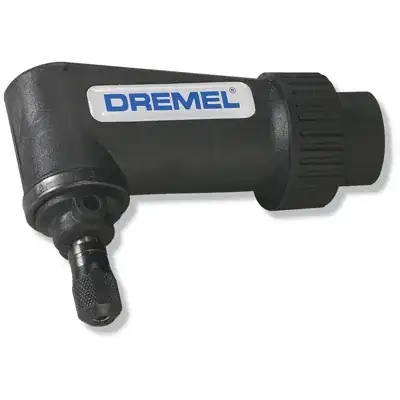

If you have access to a Dremel, you can get a right-angle adapter for it:
Disclaimer: I don't actually own this adapter so I don't know how big it is, and the specifications page doesn't say! Make sure it will fit if you decide to buy it.

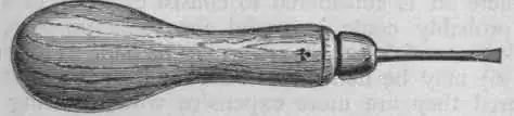

If you are going into wood or drywall, you might be able to use a Bradawl, which wouldn't be much larger than a standard screwdriver.

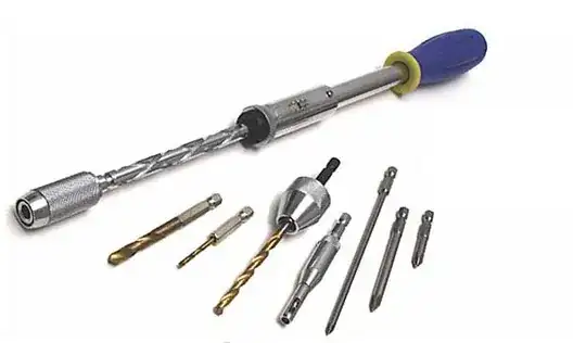

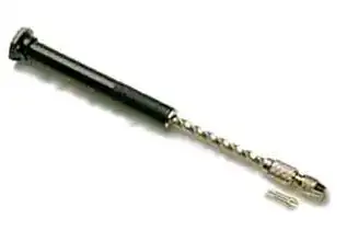

I've not used the Bradawl mentioned in another answer, but I have used a push drill. As you push down, the bit rotates clockwise, cutting the hole. When you release, the handle springs up and the bit rotates in the other direction. So you are making a push/pull motion.
A quick search turned up several different sizes of push drills.
Larger Push Drill
Small Push Drill
