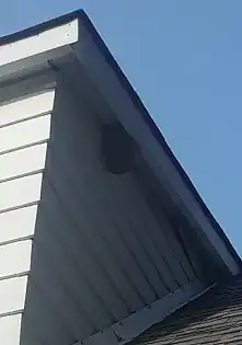

I have a hornets' nest that I want to spray with insecticide.
The hive is approximately 20-25ft from ground level.

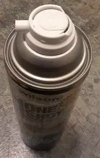

The insecticide that I have is in a aerosol spray can with a large actuator.
While the product is marketed as having a range of 20ft, I have found this claim to be false. In reality it only has a range of 6ft.

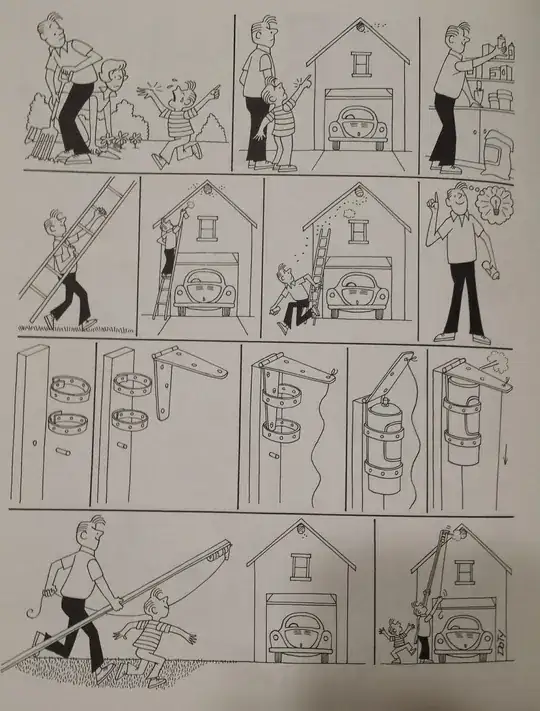

Instead, I would like to build a pole-based contraption that would allow me trigger and spray the can from the end of a 10ft pole.

That's from Best of Wordless Workshop by Ray Doty; the original was a monthly column in Popular Science. (Published sometime between 1971-1985)
The retail versions probably make more sense, but you can hum the theme from the A-Team while exterminating with this one. Besides, Wordless Workshop was a great feature.
