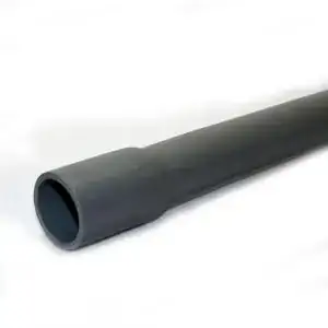

You can do all of this using weatherproof boxes and conduit especially if you are not opposed to having conduit visible. It will only require a single 3/4" hole through the wall.
Supplies:

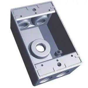

1-gang rectangular weatherproof box.

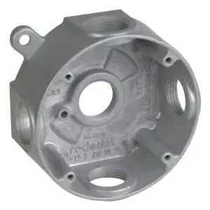

round weatherproof box.

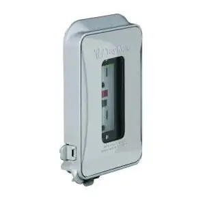

1-gang In-use cover.
3/4" PVC conduit.

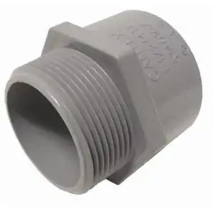

3/4" male terminal adapters

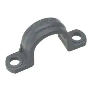

3/4" PVC conduit clamps.
Procedure:
Start by boring a 3/4" hole through the wall where you want the conduit to pass through the wall. You can hide the hole by entering the receptacle junction box from the back knockout, so the junction box will cover the hole.
Next you'll want to slide the conduit through the hole, and seal around it using either silicone caulk or Duct Seal. Then using the 3/4" male terminal adapter, connect the conduit to the rectangular junction box. Seal the rest of the knockouts in the box, using the supplied knockout plugs (leave one open to run conduit to the light box).
Seal all but one knockout on the round box using knockout plugs, then mount the box where you want your light. Using a couple more 3/4" male terminal adapters, connect a length of conduit from the rectangular junction box to the round junction box.
Pull the cable, and install the fixtures.
Finish the receptacle installation with an In-Use weatherproof cover, this will allow the box to remain weatherproof even when things are plugged in (I like the low profile models, because they are less noticeable when not in use).
Use the 3/4" PVC conduit clamps to secure the conduit to the wall about every 24-36".
