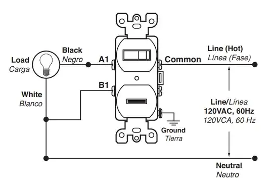

I installed a new single pole switch with pilot. Now he pilot of the new installed switch is on all the time. Did I do something wrong?
Bumpa
Most likely, you have the hots reversed. In the example clip below, the wires on the Common and A1 terminals reversed.
pilot switch
