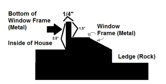

A little bit about the setup: The apartment is the 5th floor of a pre-war walkup building that has gone through various renovations, but none that have made it too modern. The window is about 30" wide, and is a metal frame.
There are two issues that make it hard to install a window AC unit:
  1. The window sill is made out of metal, so I can't nail or screw anything into it
  2. The base of the window has a thin (about 1/4") piece of metal jutting out of the buttom that's 2" high in the interior and 1.5" high in the exterior. This means I can't rest any part of the air conditioner on the sill - it ends up just resting on that piece of metal.

Looking at my neighbors' apartments, it looks like their units have been there for decades, and some are propped up on things like phone books or 2x4s. I'm hoping to find a safer solution than that, so I don't accidentally drop a 50 pound AC unit 5 stories. I tinkered with it yesterday (using the LG unit), and the best I could come up with was wedging the AC in at an angle and closing the window, but that didn't seem safe or stable, and left a hole to the outside because the curtains weren't flush with the window.
Is it possible to install a window air conditioner in this setup, and how would I go about doing it?

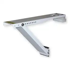

Since it sounds like it might be difficult for you to get to a lumberyard to build your own solution, you might be better off using a pre-made product. AC-Safe, makes Universal Air Conditioner Supports that might be useful in your situation.
The system requires you to screw the platform into the window sill (which may or may not be possible in your situation), then simply rests against the outside of the building to support the A\C unit.
I've also seen brackets that mount to the bottom of A\C unit itself, and offer support against the outside of the building (but I was unable to find an example online. I think Thermwell makes them).
I have the same NYC metal windows, and I'm using a universal bracket like the other commenter posted. I drilled two small holes in the bottom of my window frame (where the sash rests when the window is closed) and screwed the bracket into the wood below. The foot of the bracket rests on the stone window ledge.

Could you use something like this?
http://www.amazon.com/Safety-Kingdom-Products-ACSN1-Length/dp/B008K6VBPY
It's been working well for us!
