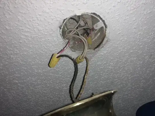

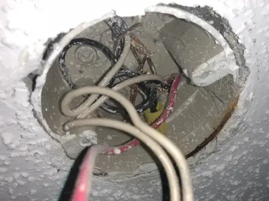

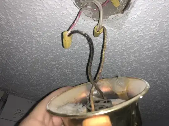

(Photo below). Is this safe?
Just a homeowner who has changed his fair share of fixtures and outlets... but have never come across this.
Two whites leading to the fixture white.
A red wire leading to the fixture black
And two black wires in the back that I don’t know where they’re going?
And bare wire (assuming neutral) just coiled up in there.
And there is burning/charring around the electrical box and inside the old fixture.
Is this configuration safe?enter image description hereenter image description hereenter image description here

I don't think that's really burnt...
The closeup of the red wire linked in the comment does not appear particularly burnt to me (it'd be a quite strange spot to have a burnt spot, anyway).
The setup is good
What this setup appears to be is a new-style switch loop that provides neutral at the switch box, which is now required by the NEC (so that fancy dimmers/smart-switches/timers/... don't have to pull dumb stunts to power themselves). The black wires that are nutted in the back of the box are the always-hots (incoming from the power source and outgoing to the switch), the red wire is the switched-hot coming back from the wall switch), and the white wires are all neutrals (incoming neutral from the power source and neutral off to the wall switch location).
One potential issue though
One thing I would check while you have this box open though is to make sure the grounds are made-up properly; the installer may have simply twisted the wires together without using a nut, which doesn't guarantee a proper connection. I would take all those bare ground wires, untwist them, add a ground pigtail to a 10-32 self-tapper (Garvin GSST or equivalent) driven into exposed metal on the fixture (this takes care of grounding the fixture), insert them into the correct size wirenut, and twist the wirenut on, so that you have them properly connected from here on out.

Is this lamp junk? If so, cut the wires right here
Strip those wires, get some orange wire-nuts, and splice the new lamp's black/white to the like colors. And you're done.
