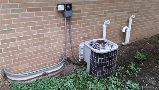

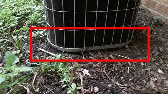

In budgeting time and money for a house I just purchased, the inspector noted that the central air conditioner is mounted outside without a pad underneath. The unit is a Carrier 38CKC024330, manufactured in 1999. The product data I found online lists using a unit riser (a.k.a. pad) as 'Recommended.'
I live in the Midwestern United States, which enjoys high humidity and harsh winters. I'm not sure how good the drainage is in the area of the unit, but it is mostly sheltered by the eave of the roof.
AC unit
No pad
Given the age of the unit -- both how it may be nearing end of life, and how it has survived this long like this -- is it worth installing a pad underneath? Are there alternative techniques, say digging out a perimeter around the unit and filling it with gravel?

Most units require a pad when installed . at the age of the unit I would probably not try to put a pad underneath as this may create a leak. In 99 the common refrigerant was R22 and the cost of a recharge if a leak is created may cost close to $1k as r22 is being phased out and local shops in my area charge 100 per pound.gravel around the unit could keep grass or weeds from growing close to the condenser coil but at this age I would not want to move it but want to keep it clean so it will last as long as possible.

In Florida we call them hurricane slabs. I have been in air conditioning industry for 25 years. I believe a slab (what ever anyone wants to call them) is a good idea. They can help keep the bottom of the condenser from rusting out. But only install on a new system at this time. Don't try to have someone left unit to install, it may cause damage to the unit. It could be rusted out by now. You have a old system, get an installer to replace it. You have a 2 ton system.
