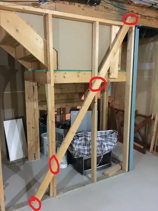

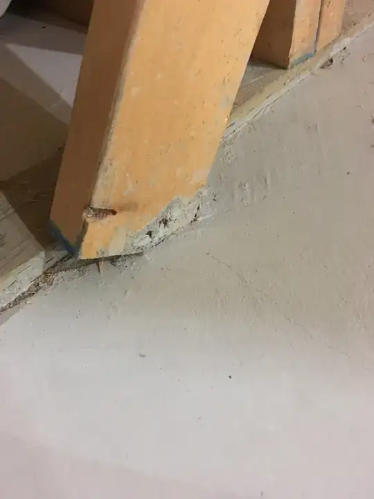

I have a diagonal brace running across an interior wall in the basement, and it even goes partially into the floor concrete. Is this meant to be permanent, or was it supposed to be removed during construction?
I want to finish the basement and put drywall there, but this obviously gets in the way. What are my options for dealing with it?

Top of the brace Bottom of the brace goes into floor

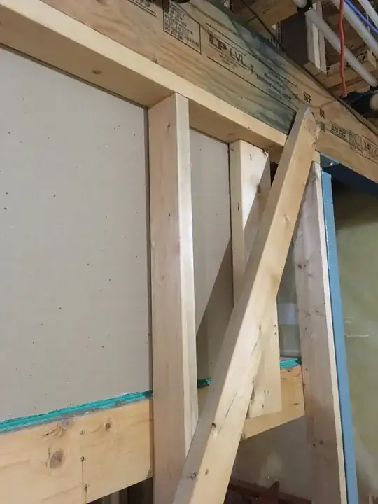

Nail locations. 3 nails into the beam at the top, 2 elsewhere:
Nail locations

Yes, you can remove the brace because:
  1. The wall is non-load bearing (not carrying a load)
  2. The diagonal brace is not secured in a manner to transfer any load at the top or bottom
  3. The diagonal brace is not secured to top plate
  4. The diagonal brace is not secured significantly to vertical stud...the picture cuts off a portion of the brace that crosses the stud so I’d verify that
  5. The diagonal brace is singular

That wall is load bearing; it is helping to support the stairs and that landing.
As such, it can be subjected to significant load (think two 250 lb guys, plus heavy furniture, for starters).
More importantly, it is subject to lateral impulses from people and things going up and down the stairs so it should have lateral/diagonal bracing to help stop "rhombusing".
Such bracing will give the stairs a solider feel and also reduce cracking/popping in the sheetrock.
There are a variety of metal bracing products you can use, but it would probably be sufficient, in this case, to nail 5/8's plywood to the backside of those studs (in addition to the sheetrock on the front side.
I'd also use some steel L-straps on the other 2 landing supports (if there's not already something there).

It is/was a temporary brace, it is safe to remove it.
10-10-2020 EDIT
During the fabrication of the wall, or before the floor system was added overhead the brace was added to stabilize that small wall section, perhaps before the beam was added. The beam in the picture, typically goes from foundation wall to foundation wall, although there can be many exceptions. Still, this hold true... the floor system is now in, that in itself is a huge brace with al the plywood set to the joists that are tied to the beam. Even if the beam that is over the wall in question was not tied into either wall, the floor alone would not allow the beam to move, and therefore the wall in question to rack.
If there is a concern for this non-bearing wall to move or shift or whatever.... and it is a non bearing wall because of the beam over it and a steel post beside the wall to support the beam..., albeit short, the diagonal of the stair carriage WILL hold the center of the studs sable if the carpenter who set the stairs did his job and fastened them to the framing the way he should. The landing does the rest.
As a mention, the concrete floor has a leveling layer of concrete over it. Not only the end of the diagonal in in the floor, the plate it is nailed to is in the floor as well, by about 3/4".
