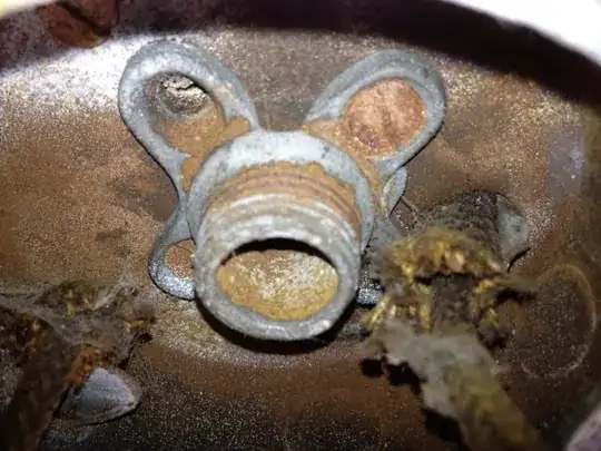

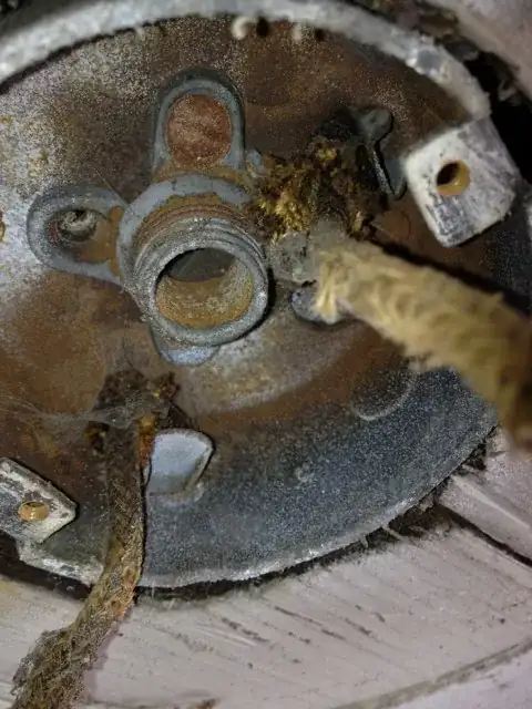

I have a modern external light fixture that needs to be attached to an existing exterior electrical 'box'. The older parts of the house have knob & tube wiring and there is evidence of gas plumbing for lighting before the knob & tube was installed. Here, i think but am not certain, it appears as if the knob & tube comes into a 'box' around an old gas line (see photo) but I may be mistaken.

Edit: More pictures as requested:

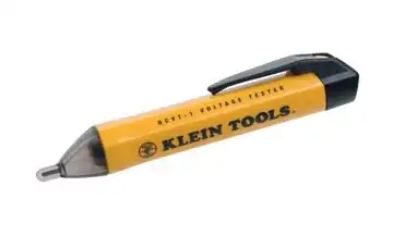

Use a NCVT (non-contact voltage tester) and see which of the two wires alarms when the switch is on. That will be your black/hot wire. If both of the wires alarm, stop, do not pass go, something else is wrong.
Non-contact voltage tester

In this case I would carefully remove any cotton or cloth covering on the existing wires, after shutting off the branch circuit. Hopefully this leaves you with a rubber or plastic layer, but either way it will be ok. Now push those wires back into the ceiling as much as you can.
Mechanically rip that entire metal electrical box off the building. A non-contact sensor can help you figure out which wire is hot (black) and which is neutral (white). Ignore the ground wire for a fixture nobody can touch.
Install a new plastic box. Slip loam over the old wire, or wrap well with friction tape (use white and black). Thread the wires through the new plastic box and screw it in place. Install your light fixture per the directions.
That wire that's in your ceiling is probably Knob & Tube: soldered and really bulletproof, it does not really even need insulation because of the knobs and tubes. By replacing the junction box you remove the one weak point.
And for bonus points: find an electrical supply house than can sell you some "loam" for Knob & Tube wiring. Use this instead of friction tape. Or, use heat shrink tubing, which works pretty well.

The correct answer is: Redo the wiring all the way back to the panel.
The workable answer is: The wire with the black stripe on the insulation is BLACK. The other one is white. The junction box is probably not grounded, but I'd attach the ground wire of the light to the junction box anyways.
Safety wise, the ground isn't entirely necessary on a ceiling light as it is pretty unlikely that anyone will touch it.
But seriously, consider replacing the wire right back to the panel. It can be a pain to pull it, but modern wiring is much safer.

Always attach a ground to a light fixture regardless if someone can touch it. what happens if the fixture has a short in it but it doesn't blow fuse becaus there's no ground, it'll catch on fire and continue to burn, please consult a licensed electrician. As an electricia n I wouldn't even install a light fixture on a knob and tube box nor would I replace a plug, I would cap it off with a plastic cover and give you an estimate to replace the whole line with new wiring, knob and tube is extremely dangerous. Sincerely, a licensed electrician...
