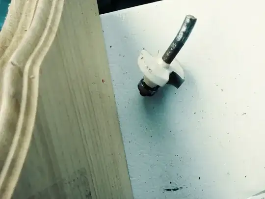

Long story short I was running my DeWalt fixed base router (8000-24000 RPM) on a piece of work when it started making a funny noise.
I lifted the router up to see why it was making the noise, and FWOOOM the router bit launched itself into the air!
Router bit after launch
I found it on the lawn on the other side of the house, with the stalk all twisted to one side. It landed in soft grass so that damage must have occurred while it was in (or exiting from) the router.
No injuries occurred thankfully, but obviously someone easily could have been hurt. So, what happened? Was it just loose? Is my router card revoked and I should just go back to belt-sanding roundovers? What safety steps could I have missed? Thanks!
If the router bit was in the collet the correct amount and tightened correctly then you should have no issues. I noticed a few things when looking at your picture, it is an older shank that had some rust on it and a few dings, it is possible it is not seating correctly in the collet.
With that said there is the possibility that the shank walked out of the collect because there was to much pressure in a climb cutting position. In other words the shank was rotating clockwise and you were moving left to right, the router bit is walking over the piece and every once in a while it grabs and pulls the shank out of the collet slightly like a screw. It DOES NOT matter how tightly you lock it in the collect.
Working in the machine shop, milling machine work the same way, I have see cutters come flying out for the same reason. It happens. Best advise is to work right to left and avoid climbing on the piece, finish will also be better. If you must climb take smaller cuts.

It is possible to put 6mm shank router bits into a 1/4" collet (and vice versa), however you SHOULD NOT do this because they won't clamp down properly. This could be the cause of this bit coming out.
Also, to reiterate dwizum's comment do not pick up the router until the bit has stopped spinning. This is a good safety tip at all times and especially when you think something has gone wrong.
