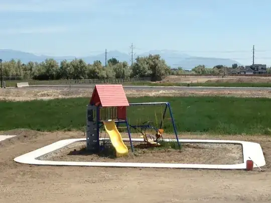

What is a good depth for putting bark in a playset? Here's a link to a picture of the project so far:
The Consumer Product Safety Commission has a chart for this:
http://www.cpsc.gov/cpscpub/pubs/323.html
Fall Height In Feet From Which A Life Threatening Head Injury Would Not Be Expected
Type of Material            6 "Depth    9 " Depth    12" Depth
Double Shredded Bark Mulch  6           10           11
Wood Chips                  7           10           11
Fine Sand                   5           5            9
Fine Gravel                 6           7            10
