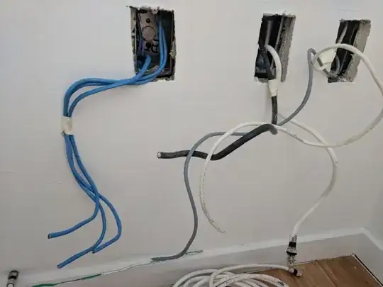

It seems like the builder has run an assortment of unterminated wires to a 'telco closet'. There are 3 blue Cat5e cables, one white Cat5e, and one grey Cat5e.

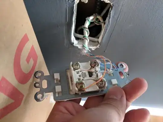

Around the unit there appears to be an RJ11 that terminates the other end of the white cable with four wires:

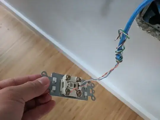

Plus two RJ11 jacks that look the same, except with a blue cable:

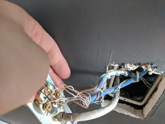

Plus two RJ11 jacks that seem to have some sort of daisy chain situation going on with the blue cables:

  2. Why are some of the RJ11 jacks terminated with a single cable and others daisy-chained?
  3. There are 3 blue wires coming out of the telco closet and 6 blue wires emerging elsewhere in the house (2x single and 2x double). This seems to imply a logically impossible daisy-chaining situation to me, and I've looked very hard and not found any other RJ11 jacks. How could it be wired this way?

  5. The grey Cat5e doesn't seem to emerge anywhere in the house. What might it be for, e.g. it is connected to a central patch panel somewhere in the building? Is this a common situation?

  1. I'm no pro, but I'd say you can do as you wish with low voltage cable
  2. I'd guess the daisy chaining was a poor mans way of propagating the phone cable without running it back to the closet.
  3. Yeah, see the last answer
  4. I'd remove the phone jacks and short out two of the pairs with clip leads. Then use a continuity tester to map out the cables.
  5. Does the grey one lead to the attic somewhere?
