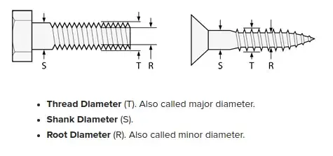

Look at the lag screw, observe the diameter inside the threads (R, the "root diameter") in the illustration below) not the thread diameter (T). Match up a bit that's slightly smaller than the root. It sounds like you have 1/4" hardware and a 3/16" bit would be fine.
screw diameters
