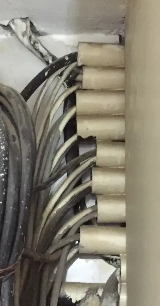

Here's some old wiring done in my absence as my parents could only monitor so much.

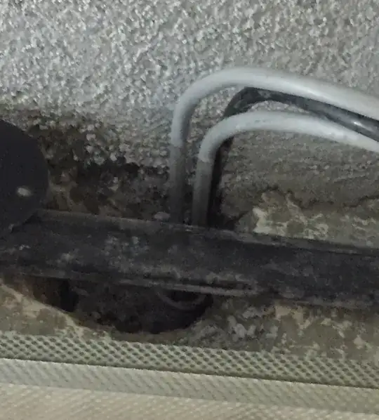

Hate the use of Skinnier version on Flexi Pipe that won't allow any movement or pull once initial install is done. Crappy. (Hidden behind the black pipe)
flexi pipe 2 cat 6 + c1 coax
2 Cat 6 + 1 Coax
It comes out over here at one of these pipes. I forget which one (we traced it w physical push pull)
conduit pipe 3/4 or 1 inch
Conduit Pipe is 3/4 or 1 inch. Need to check in morning.
