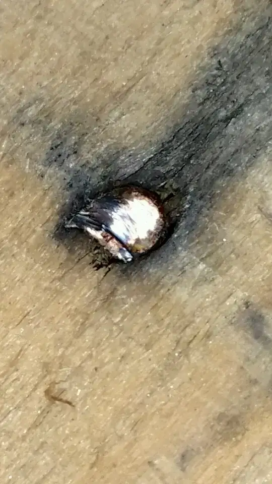

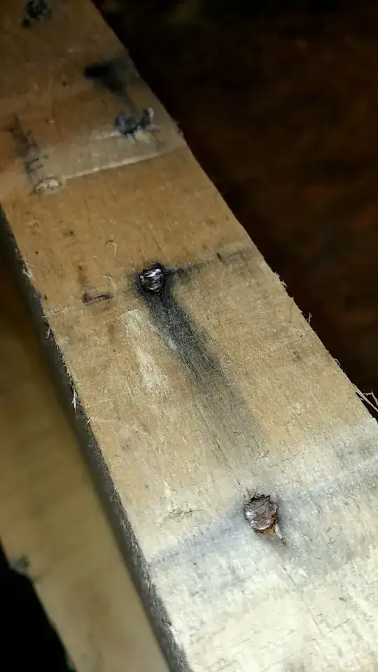

I have some boards that have the nail heads removed, leaving the nail flush with the surface of the board. The boards come from pallets where apparently they used a sawsall or cutoff blade to reconstruct the pallets several times:
Side view:
Close up view:

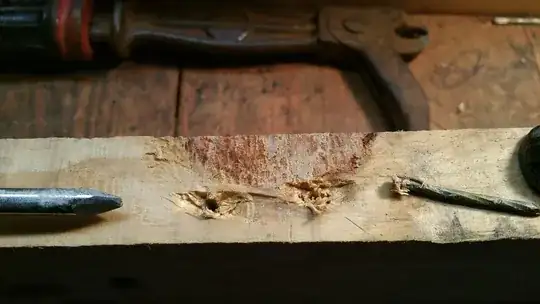

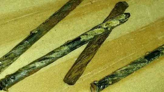

After prying them out, I see tiny wires around the outside (my guess is to actually prevent removal ... what are these nails called?):

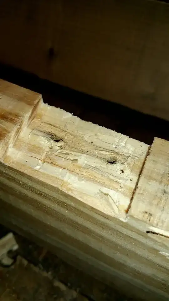

Since this is for shop use (not fine furniture), and I don't need to preserve the whole width of the board (but do want to preserve the length), I have been cutting a notch into the wood about 1/4" deep, and chiseling the wood out just enough to get a ViceGrip around the nail, and then slowly prying up the nail and ViceGrip with a long crowbar. I can subsequently rip off the edge of the what is left over of the board and reuse most of the board.

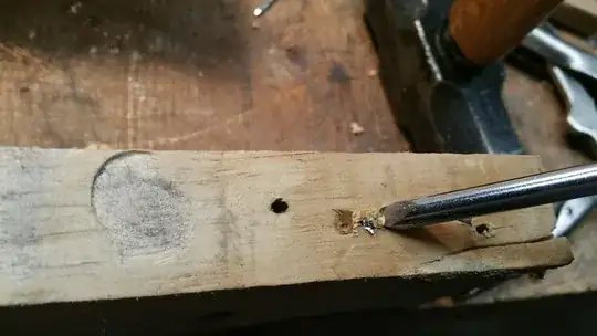

Here is a view of the result after I've pryed out the nail:
That works but is time consuming.
Is there a tool that would both dig into the wood and around the nail, and have enough gripping force (similer to what I can get with the ViceGrip) to allow me to then pry out the nail? The "Nail Jack" style of tools are close but they don't have the toggle-bolt gripping action of a ViceGrip and lack a way to hammer the chisel edges into the wood deeply enough to grip the headless nail body.

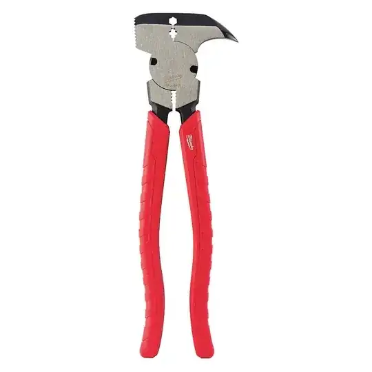

When I had to remove several hundred nails from hardwood flooring, I used something called Fencing Pliers. The flat part at the top of the tool could grip a small section of nail protruding from the floor and the curved edge of the tool's head provided leverage to extract it. It did require a very small amount of the nail protruding from the wood. Based in the image you provided, I think there is enough. The tool was under $50 and in my case was well worth it.enter image description here

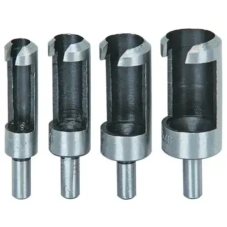

You might consider a plug cutter.
plug cutter
You could use a plug cutter like this to drill around the nails.

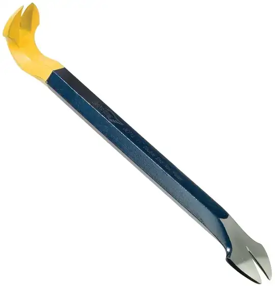

If you don't mind making a small divot in the wood then you can use something like this Estwing Pro-Claw Nail Puller.
You just have to position the claw at an angle and strike the backplate to dig the claw into the nail shank. It will essentially create its own grip points so that you can pull the nail with ease.
I own one of these and I absolutely love it. They are sold in different sizes so make sure to get one which is suitable for your need.

In those cases, I used a old screw driver that I ground down to a small sharp 1/4 inch chisel edge (because I wasn't about to use one of my nice chisels for this). I would then pound down to the left and right of the nail to give the nail puller's jaw a fighting chance at gripping the nail:
screwdriver chisel at work

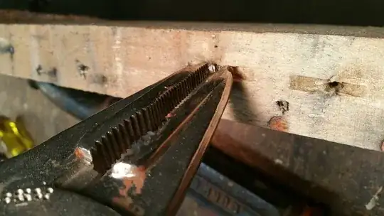

In some cases even that was not enough, and I had to resort to using a long-nose vicegrip pounded down around the nail body and then levering it out that way. See this YouTube video https://youtu.be/DsgaLMmHCF8 :
long-nose vicegrip

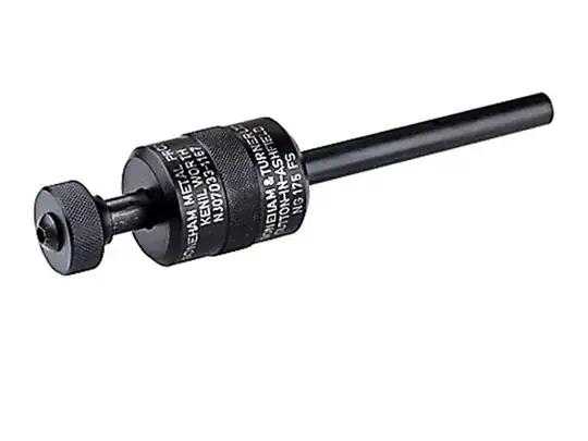

Use a plug cutter to expose about one inch of the nail.
Then use a chuck extractor. It is composed of a chuck with a long shaft on which a weight can run (don't be grossed out, but I've seen one at my dentist's).
The chuck takes hold of the nail and is serrated tightly. Now nail, chuck and shaft are a single body. You hold the weight and drive it away from the chuck along the shaft, until it smashes with the block at the opposite end. This has the effect of pulling out the nail. Repeat as needed.
This is a variation of the same tool, with a differently (and unsuitably) shaped chuck:
In the end you're left with a small hole on the wood, with a nail hole at the bottom. You can even plug the hole with a wood insert of the same size.
