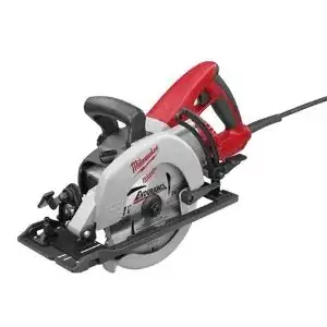

It's been a while since I've been to job sites, but a few years ago the tool of choice was a Milwaukee Worm Drive circular saw.
Things might have changed with well known brands switching to plastic gears, but the torque on these doesn't get much better. They are also well known for having less kick-back problems.
