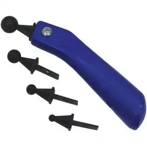

For those of us who don't have the magical touch, they make tools that allow you to put a nice finish on. There are a variety of different tools - this is just the first one that came up in a search.
Caulk Packer Tool
