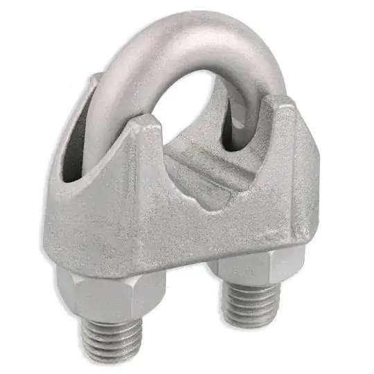

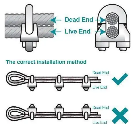

Assuming you were thinking of using these ferrules to terminate wire rope, and you're only making a few connections and not hundreds, my advice is don't use them at all: use Wire Rope Clips instead.
Wire Rope Clip
They're not quite as cheap or quick to assemble, but if you're only doing a few, there's not much difference, and the only tool you need is a wrench.
Note that unlike the ferrules, they do have to be installed a particular direction.
