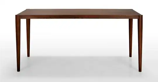

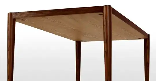

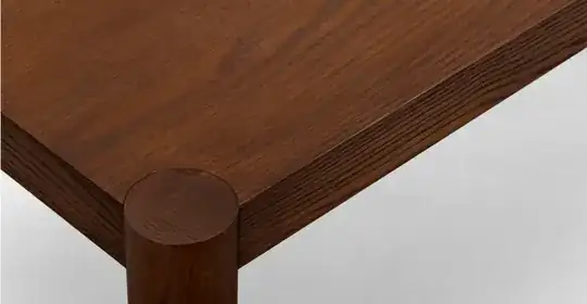

I (a beginner) would like to build a table of this form.
Table view Table view corner Table view underside
Does anyone know what kind of corners are used to connect the legs, or any other construction tips.

It could possibly be done using Mortise and Tenon joints, however, it looks like this table simply uses Hanger Bolts.
If you look at a picture from the bottom of the table,
you'll notice there are holes bored in the underside of the table top. This is likely where the nut would be attached to the bolt, which is in turn screwed into the leg.
