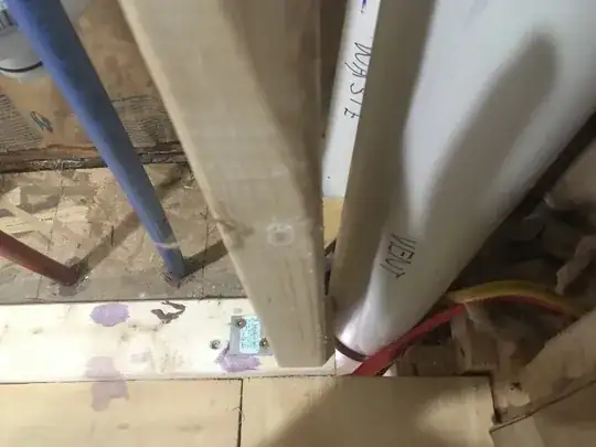

I've created an access hole in my subfloor for a couple pipes and a few electrical wires to get down into the crawlspace. It's coming up through the floor behind a chase wall, but the space is super irregular. I need to fireblock and also keep out rodents.
Would fireblocking foam meet code? I see a lot of posts that foam's just not actually effective fireblocking. Nonetheless, I'm thinking maybe some hardware cloth and fireblocking foam would do that job.
Does anyone have thoughts or suggestions?
