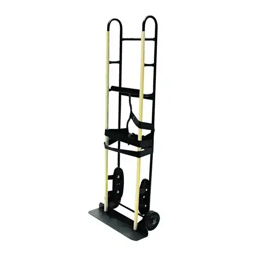

Wheels! I would recommend a hand truck, furniture dolly or a wheelbarrow.

I've been in your shoes. I'm not aware of any suction type of tool. There are powered carts of many types and sizes available for rent but the stairs will pose a problem. I've been dreaming of buying a powered, stair climbing hand truck like the Wesco Stairking some of which auto level but I have never seen one for rent. They range in price from around 4,000 to 12,000 Canadian dollars. For that price you should just hire someone, or a small army of someones. I found taking bicycle inner tubes cut and tied just slightly smaller than the square dimension will protect the edges from chipping. You can even lay them down and get them close to position before removing it.
