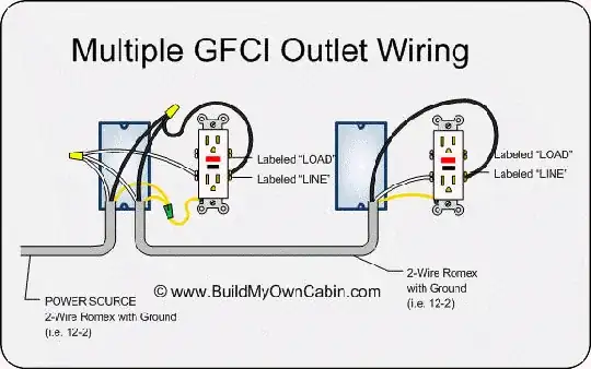

Let's see if we can answer this in pictures. For one feed from the breaker panel, to have each of the outlets on their own GFCI, you want this: enter image description here

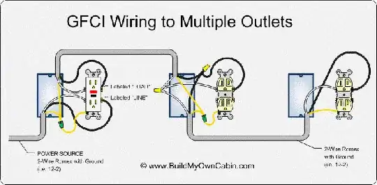

For one feed from the breaker panel to have one GFCI protecting downstream outlets, you want this: enter image description here

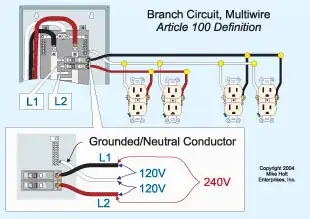

However, you say that you have a red and a black wire in the box, and this complicates things. You might have a MWBC (multi-wire branch circuit) feeding the outlets, with the red hot on one outlet and the black hot on the other:
