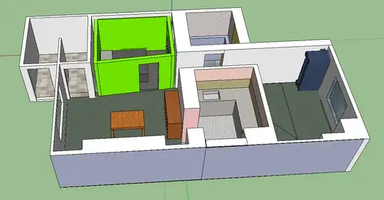

This is a scale model of my apartment (where the green room is the to be the sound-proof room) New Layout

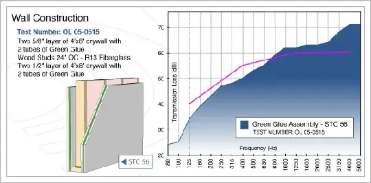

I've been reading about soundproofing and things like STC level (http://en.wikipedia.org/wiki/Sound_transmission_class). But I've also read the STC level does not indicate low-frequency performance well. My room might achieve STC level 60; but I might might only get a 20dB reduction in low frequency banging. I don't want to do all this work and spend all this money if I'm still going to have loud noises I can hear. This chart illustrates what I'm talking about
STC and HZ Freq
I'm not sure if I understand how dbs work; so maybe my math here is wrong...but...I feel like I need a to get the loud 80db door slam down to 30-40db level for this to be worth doing for me. Depending on the frequency of the sound; I think the chart would be able to tell me what I can expect - but I don't know what it would be.
