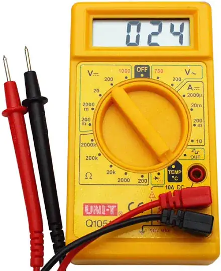

You do not need to know if there is a 'signal' you just need to know if there is a connection.
A basic tool that can tell you evetrything and costs a few bucks/quid at local hardware store. Multimeter
Never in my life did i have to use a tone generator, a oscilloscope to test if my CCTV, Satellite or TV connection is giving me good enough signal.. LOL
You use that type of equipment for digital/analogue testing where you control several if not hundred outcomes, synchronization and high speed data transfer.
You just need to use a few simple free (brainpower) tricks.
Point A being nearest to your TV and Point B being the other end of the cable.
  1. Disconnect all TVs
  2. Short point B (so connect the signal and shield with a wire)
  3. Test point A with a multimeter set at Ohm
Results
  • ~0Ohm or very close to - Woohoo you have a nice connection from a to b!
  • 0Ohm More than dead short - You have a bad connection somewhere
  • No reading - Cable form Point A to Point B has no connection
There is no need to analyse the signal or test for a signal because you know you have a signal in the other TVs (assuming the coax is connected to the same place)

Multimeter F.A.Q
And a photo to make it look pretty.

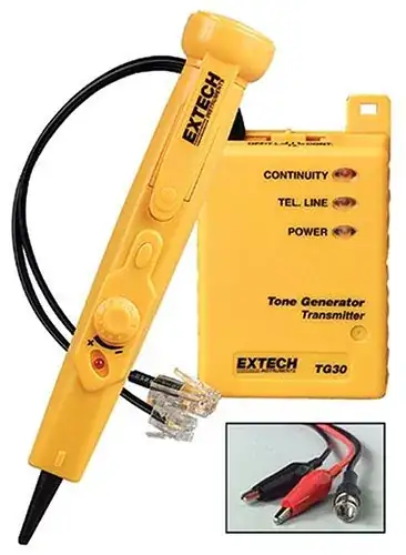

You can use a Tone Generator to find where the break in the cable is. It's still not a free option, but definitely cheaper than a signal generator. If you have a friend or relative in the phone business, those guys always have one of these in their tool belt. IT guys quite often have them too.
I'm honestly surprised that the cable guy didn't do it for you, it would have been quicker to find it for you than to explain it to you. I guess they take the premise wiring limitation pretty seriously.
