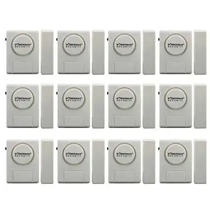

Would these alarms be enough?
Adhesive Alarms
Not sure about shipping to you place, but the 12-pack is listed as $30. The ad mention it is 100db, and have a manual switch. Just place them over the 54 inches and it is done.
It's cheap, it's easy, and you still got like 5 more to use on different places if you like them
