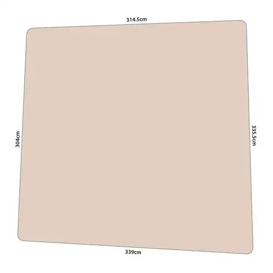

I've been given the Christmas task of setting up an HO model train and rails around a child's room, so I researched a bit and found a shelf train would be the thing. So I go to measure the room in order to figure out how much wood I have to buy to make the the shelves (already thinking about how I'm going to make the round cuts for the inner edges with a simple hand saw...) when my measurements turn out to be: 314.5cm x 335.5cm x 339cm x 304cm... Yes, someone has been able to pull off this masterpiece of a room:
The Most Skewed Room in The World
(Now, I'm not sure a bout the actual shape of the room, because as you can see, they had the delicacy of rounding the corners—to soften the magical skew effect, I guess—so it's impossible to measure angles. What I did was create lines in Photoshop with the lengths I took and simply found a way to connect them so it feels right with what I'm actually seeing in the room.) I guess my predicament is by now obvious: how on earth am I going to correctly measure and cut this shelf?!:
Skewed Shelves
The mere thought of trying to find the correct angle for the corners and the correct radius is daunting! Not to mention the seeming impossibility of how to solve for the 2 corners where the angle will be obtuse and there'll be gaps between one side of the shelf and the wall!
Is this an impossible DIY project? What do you guys think? Am I perhaps going at it wrong and there might be a better, easier, (saner), way of going about it? Thanks in advance for your help!

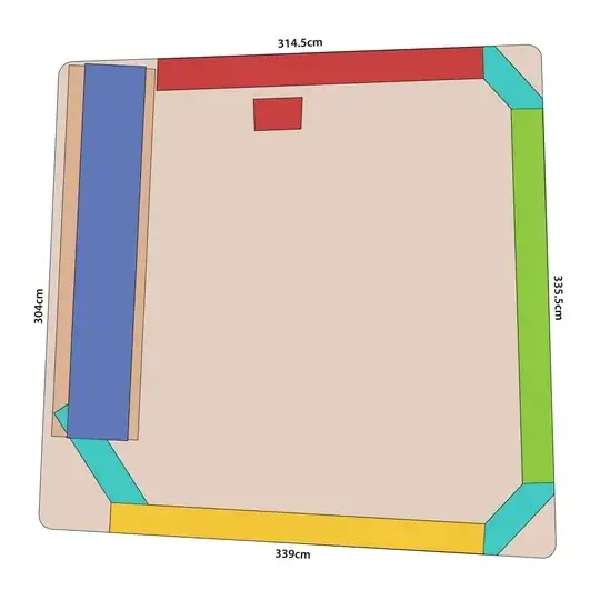

One poster had a similar idea to a second, less elegant, but much more practical shelf layout I had also thought of:
Final shelf layout
I avoid the curved corner details and having to deal with them and, at the same time, make it more practical to fit together the whole setup without that much of a hassle due to the wonky, skewed construction of the room.
Don't pay attention to that red block floating around the top, it's just a leftover piece of shelving panel . I virtually "cut" a large panel of 244x120 into 4 244x20 shelves and a larger 244x40 shelf that goes on top of the closet that's to one side of the room—yes, on the original design uploaded I didn't have the closet drawn in... that's another obstacle I've had to jump over... quite literally (more on that after). And I'm happy to see that I can get all the material I need from only one panel, which will save me some money.

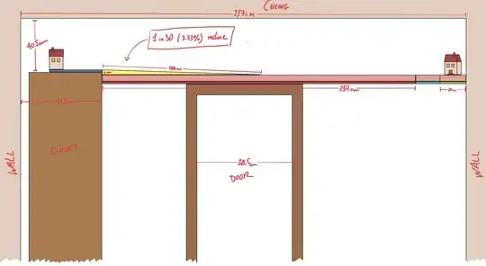

To answer another particular a couple of you mentioned: I'm clearing all doors (there's 2—no windows) by placing the shelving flush agains the top of the doors' lintels and then going around the room at that height. It's not a small child's room, so the height isn't really forbidding; plus, she's tall, so she can manage. She really likes HO trans, and will be getting up close to her set when she wants to work on the model but, otherwise, it's more of a relaxing scene for her to see as she lies in bed, especially at night, and falls asleep with the sound of the train rolling by. Now, as I mentioned, the closet is another big obstacle, as it stands 9cm taller than the lintels, so I can either raise the entire shelving a further 9cm (which I'd rather not, as it does start to become more of a ceiling train) or I can have inclines going up to and down from the shelf on top of the closet. I'm thinking of putting 50mm pink foam on top of all the shelves except the one on the closet; which would help me make it so that the incline that has to go up and down from the lower shelves to the top of the closet would only have to reach up 4cm, which would mean I can get a good 1 in 30 incline starting at 120cm from the closet (perhaps a little diagram will help better show what I'm talking about exactly):
1 in 30 incline diagram
I understand a 1 in 30 incline is about the bottom margin recommended for an HO gauge train set, as it's already a 3.33% incline, which is way more than any prototype rail actually has. Because we're talking about a passenger train, with a rather strong British Gresley A1 locomotive and 3-4 pullman cars, I think there'll be no problem getting up and down this slope. Now, I've read somewhere that a 1 in 30 incline is really not ideal (aesthetically speaking) for a model main line. I personally don't see that but perhaps do understand there might be a lack of realism. All-in-all, if you can't get up to 1 in 60, which seems to be the best ratio, 1 in 50 is a preferred incline for serious modellers and, indeed, I could even get it up to that:

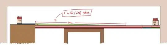

1 in 50 incline
I don't mind it visually. It may even be interesting to create some sort of mountain side view for the inclines. What do you guys think? I guess I'll know for sure once I get the tracks in place and do a test run with the loco.
As I said before, I could just raise the entire shelving and have it flush with that on top of the closet. If I connect all the shelving (including the one on top of the closet) then I'd be raising the entire set 9cm and I could also put some foam on top of the shelf on the closet. If, however, I just raise the outer shelves enough to get the foam flush with the shelf on the closet (and don't put foam on that) I only have to raise the thing up 4cm. Now, 4cm higher or lower doesn't seem like much and perhaps is not worth the hassle of having to make inclines... I don't know. 9cm already seems like something considerable, but perhaps in the end, visually, it's all the same... What would you guys do?

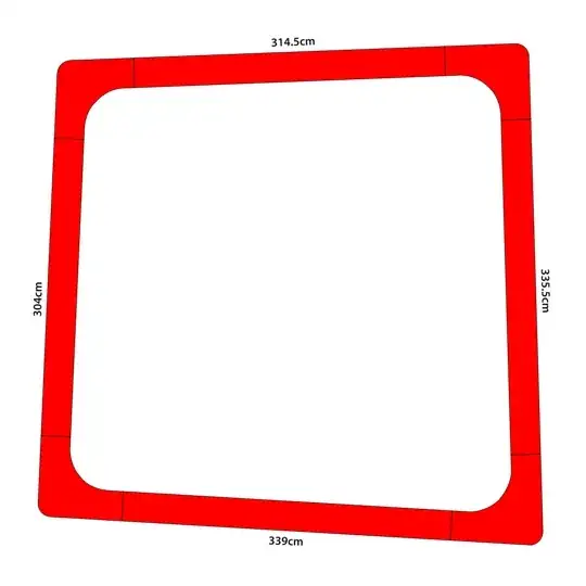

I realised quite a lot of you are worrying I may be in for a couple of bad surprises.
The first, and perhaps more worrisome: that once I work all of this out I'll realise the HO train set's rails just don't fit what I've made!
Well, don't worry about that. I have taken this into account, which is why I need those rounded or diagonal corners. The first thing I did was use AnyRail to build up the basic track layout with the parts I'm getting in the set I bought, to see what other pieces of track I need to buy and, of course, to see if the room could hold a nice and viable shape. This is my current track laid over the room and shelving diagram:
Track over diagram
In the diagram it fits almost exactly in some parts, which gives me some confidence, as that means I'll be able to make it fit even better by working a little with the track.
